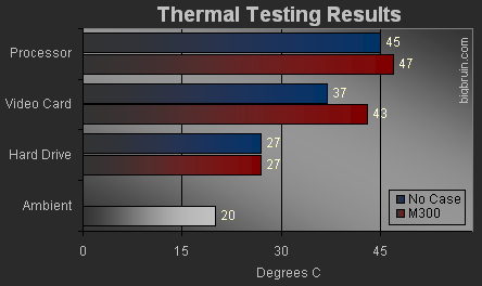

Thermal testing consisted of monitoring the temperatures of the processor, hard drive, and video card while the system was used as normal; web browsing, playing MP3s, streaming XM radio, running GPS. The processor and hard drive temperatures were monitored using Speed Fan software, while the video card temperature was monitored using the nVidia control panel software.
The results above are all with two case fans installed and the video card fan active. You can see the temperatures are all relatively low and there is definitely room for the reduced air flow that would accompany using just one case fan. The case provides decent air flow with those two little fans, and I believe the metal cover helps to draw heat away from the hard drive and perhaps even the video card.
