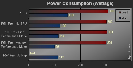

While the software indicates that the power to the CPU was being cut by up to 60% when shifting to lower power modes, I was more interested in total power savings. The CPU is just a small portion of total system power consumption, so a Seasonic Power Angel was used to monitor the AC power draw of the whole computer.
The chart below shows the idle and load results for the P5KC, as well as the P5K PRO as monitored in a variety of configurations. The idle conditions were established by leaving the system and the Windows desktop for 15 minutes with nothing running, while the load condition was established by running 3DMark06.
As the information above reveals, even without using EPU, the P5KC uses 25% more power at idle. Shift the P5K PRO down to Medium Performance mode and the P5KC is about 51% higher. If you happen to leave your computer on when not in use, this could translate into a big savings on your electric bill. AI Nap is something similar to hibernation, but for some reason more power is being consumed, despite the computer being no longer usable. I pay about 15 cents per kilowatt-hour, which means running this setup at idle on the P5KC costs about 54 cents per day. Switching to the P5K PRO without using EPU drops this to about 43 cents per day, and letting it run in Medium Performance mode gets you all the way down to about 36 cents per day. While that is great, if you happen to leave your computer idling all the time I might suggest putting it to good use by running Folding@Home. While some cost saving benefits will be lost, your system will be doing something worthwhile.
