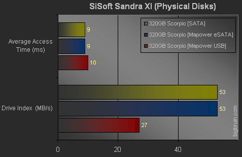

SiSoft Sandra XI's Physical Disks benchmark was run first. Here we see that there is no difference between SATA and eSATA performance, and that USB performance is about par for the course.

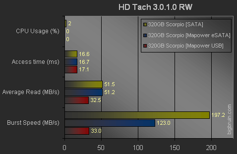

The next test was HD Tach 3.0.1.0 RW, which shows that the average read speed may not be much different between SATA and eSATA, but the burst speed is. It seems that this Mapower enclosure limits this 3Gbps drive to 1.5Gbps transfer rates. Not a big deal in reality, as it is the average transfer rate that interests me more.
Even the USB results look rather good, making this enclosure rather appealing to those who don't have access to eSATA at this point.
