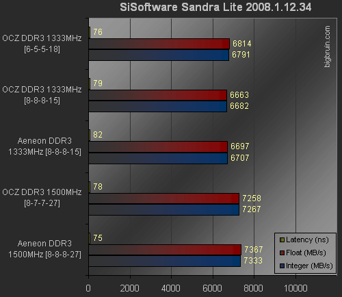

Sisoftware Sandra Lite 2008.1.12.34:
SiSoftware's Sandra was used to analyze other facets of the memory's performance. Values for integer (in MB/s), float (in MB/s), and latency (in ns) are shown below, with higher values being better for integer and float, while lower values are better for latency.
This test is another close one, but the tighter timings seemed to help produce some better numbers at stock timings. The results at 1500MHz show that relaxing the timings on the OCZ Technology 2GB PC3-10666 ReaperX HPC DDR3 Dual Channel Memory Kit takes away its edge, as it puts up lower scores in all three categories.

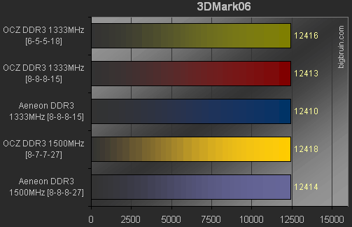

3DMark06:
3DMark06 was used to compare each kit to see if either one makes a big difference in gaming scenarios. Memory really shouldn't have a huge impact in this graphical test.
I really didn't expect a huge difference with 3DMark06, and at 1333MHz the OCZ Technology 2GB PC3-10666 ReaperX HPC DDR3 Dual Channel Memory Kit got six more Marks with the rated timings than the Aeneon kit. It is better than nothing, but you can see that the tighter timings help gain just a few extra marks. And as you can see, overclocking doesn't get you much, either.
