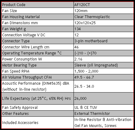

                                                                                The table above details the official specifications of the 120 mm AcoustiFan, as taken from the Quiet PC website.  As you can see, the fan isn’t rated for extremely high speeds (1500-2000 RPM), but still produces a respectable volume of air flow.  For comparison purposes I will be looking at the AcoustiFan matched up with other 120 mm fans from Papst and Delta, which can provide up to 2500 RPM, higher airflow, and from my own personal experience, more noise than I care to have!  I currently use a fan speed controller to knock the speeds (and noise) down substantially, but I’m hoping for a better balance of cooling and silence with the AcoustiFans.
  According to a chart on the Acousti Products website, the thermally controlled operation of the fan will result in a range of speeds from approximately 1600 RPM at 35 degrees Celsius up to 1900 RPM at 70 degrees Celsius.  With a speed range listed as 1500-2000 RPM, I am unsure why the chart only goes from about 1600-1900, and I am also unsure that I will ever see the full speed of the fan as I do not intend for anything in my case to approach 70 degrees Celsius!
