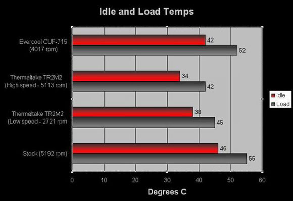

I compared the Evercool CUF-715 with a stock AMD heatsink, and a Thermaltake TR2-M2.  The AMD sink is one of the newer generation small fin aluminum type and the TR2-M2 is also an aluminum sink but sports a copper core. All testing was done on an Asus A7V333-X motherboard and a non-OC’d 2200+. All three heatsinks were installed with Arctic Silver 3, and monitored with Motherboard Monitor. Idle measurements were taken after 30 minutes of desktop only. Load temps were recorded after 30 minutes of Prime calculations with CPU running at 100%.
The Evercool CUF-715 knocked a full 4 degrees off of the stock AMD coolers idle temps and 3 degrees from the Load temperatures. It did this with 1100 rpm less fan speed also, always a good thing to keep noise down.  However, when compared to the Thermaltake TR2-M2 TMD sink, temperatures didn’t fare too well. The Evercool sink was 4 degrees over at idle and a substantial 7 degrees higher at load, and this is with the Thermaltake set at its lowest setting. When the Thermaltake is turned to its highest setting, the differences become huge, 8 degrees at idle and 10 degrees loaded.
