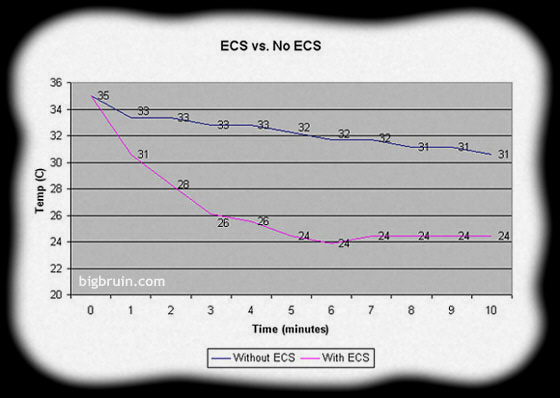

The ECS was tested on a system with an AMD Duron 1.0GHz processor with stock cooling.  To prevent case temperatures from affecting the results, all testing was completed in an open case environment.  The room temperature was also held at a constant 24º C to normalize results.  Once everything was in place, the test system was run for a period of twenty minutes to ensure it reached its idle operating temperature (measured to be 35º C at the center of the heatsink), at which point testing began.  The temperatures were taken using a digital thermometer from the center most fin of the heatsink (directly above the center of the CPU core).  Then for ten minutes the temperatures were recorded at one-minute intervals.  The purpose of this test was to compare Evercool’s suggested effects of a shutdown with and without a fan to our own results.
Performance and Results:

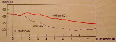

The results exhibit two important conclusions. Most importantly, the ECS does an excellent job at cooling the heatsink after the computer is shutdown. After the first minute with the ECS in use, temperatures dropped 4º C, whereas without an active fan the temperatures decreased but only by 2º C. The ECS ends up keeping the heatsink 8º C cooler in the most extreme, nearly a 20% reduction in temperature.
The fact that both the tests resulted in temperatures that constantly decreased over the first five minutes after shutdown brings us to our second conclusion. Unlike the graph Evercool provides, there was no spike in temperatures during the cooling process.  Although our graphs do not match Evercool’s there are many variables that could affect these results (including differing processors, methods of reading temperature, and CPU coolers used during the tests).
BigBruin Graph:
Evercool’s Graph:
The Evercool Extended Cooling System is a unique product that works well.  It protects your processor from the possibilities of overheating after the system is shutdown, which will give some users the peace of mind they need.  Although our test results didn’t represent a graph similar to Evercool’s, its still very possible with some computer configurations, temperatures could spike after system shutdown.  Even if this is the case though, users shouldn’t worry as Evercool’s data shows either way the processor still remains well within its thermal guidelines.
