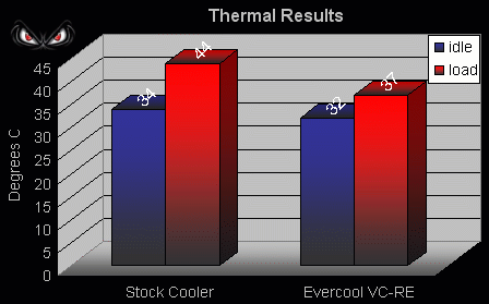

Testing consisted of monitoring and recording the idle and load condition temperatures with both the stock cooler and the Evercool VC-RE installed.  Temperature monitoring on the video card's processor was accomplished by using the GeForce4 MX 440's built in thermal sensor and results reported by MSI's 3D Experience utility.  Ambient temperatures were monitored using a SenFu Super Thermometer from HighSpeed PC.
First, "idle" results were obtained with the video card core at default speed (270 MHz) and no applications running for several hours. Next, the "load" results were obtained by overclocking the card to 320 MHz and 3DMark2001SE was launched and allowed to loop in demo mode for a period of one hour. The idle conditions will provide a good baseline for comparison, and the added heat generated by overclocking and running the 3DMark2001SE demo will put the performance of each cooler in the spotlight.
The case side panel was removed during all stages of testing to eliminate any added cooling from two fans located there, and an ambient temperature between 20-21 Celsius was maintained.
As seen in the chart above, the cooling performance of the Evercool VC-RE easily outshined the stock unit.  Dropping two degrees off of the idle conditions, and a healthy 7 degrees off of the load conditions, are accomplishments which point to two beneficial possibilities. 1) Cooler components generally have longer usable lives, and 2) the lower temperatures at these conditions should provide more headroom for an even greater overclock. Not being overly concerned about this video card being with me into old age, I decided to test possibility 2, and pushed the overclock a bit higher.  The testing used an overclock of 50 MHz, but the stock cooler had a maximum overclock of about 70 MHz before it became unstable and games were speckled with artifacts. With the Evercool VC-RE, I was able to push the core all the way up to 380 MHz (an overclock of 110 Mhz), and still had no signs off artifacts, tearing, or overheating.  A respectable overclock, with no signs that I have hit the ceiling.
