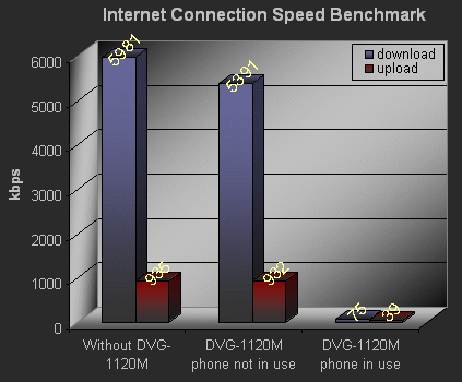

After making a few phone calls, I jumped back onto the internet to see how that functioned now that there was one more device between the computer and the world wide web. As soon as I launched Internet Explorer I was relieved to see that the connection was still intact... Off to a good start so far. I then tested the speed of the connection using the New York City based hub of SpeakEasy.Net’s speed test (always best to test on your closest hub). The chart below details my speed test results with and without the DVG-1120M installed, providing both the upload and download speeds. From left to right, the three sets of results represent my cable connection without the DVG-1120M installed, with the DVG-1120M installed while no phone calls are in progress, and with the DVG-1120M installed while a phone call is in progress. As charted, the results are based on the average of three tests run during "off-peak" internet hours and while no phone calls were in progress, so that as little would interfere with the results as possible.
As you can see from the data above, although the upload speed was virtually unaffected, a 10% drop in download speed was experienced when the DVG-1120M was installed, but not being used for a phone call. But, take a look at the speeds achieved while a phone call is in progress! Wow! That is roughly a 99% drop in speed! A phone call has a serious impact on the speed of the internet connection, and it is apparent in real world use. While browsing simple sites that generally load immediately I am reminded of the sad old days of dial-up when pages loaded painfully slow.
My initial concerns regarding the statement that "Voice service is prioritized over the data traffic" proved to be well founded. In fact, I underestimated the impact a phone call would have on the speed of my internet connection, as I would have never guessed it could take a line which has benchmarked download speeds as high as 6600 kbps down to a mere 75 kbps.
