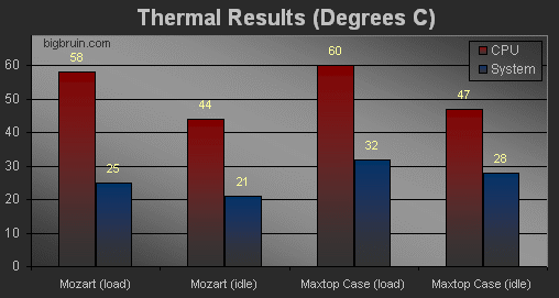

Testing involved monitoring both the idle and load thermal conditions of the CPU and the system by means of the motherboard's onboard temperature sensor. These sensors aren't known to be the most accurate, but previous testing has shown that this particular one is pretty good, plus I am simply looking for a deviation from the old case to the new case. The "Delta T" is of interest, not the absolute values.
Idle conditions were established by allowing the system to sit at the Windows desktop for a period of no less than one hour. The load conditions were generated by running a full disk scan using Grisoft AVG AntiVirus while playing back a DVD movie that had been ripped to the 300GB drive.
The closed system was not just left out in open air, but actually installed in my home theater rack, so as to best simulate normal conditions. The door to the rack is always left slightly ajar while in use, but the enclosed design doesn't make cooling any easier. The chart below details the results for both cases.
As you can see, the same peripherals in the same setting can operate at a lower temperature when moved to a new case. The idle and load temperatures both dropped, without any additional noise.
