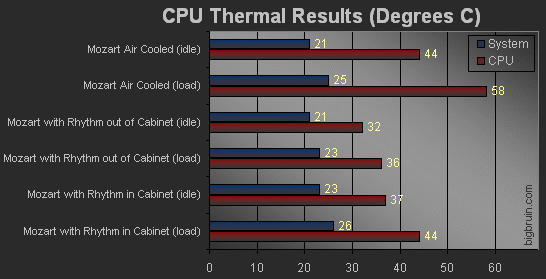

Testing involved monitoring both the idle and load thermal conditions of the CPU and the system by means of the motherboard's onboard temperature sensor. These sensors aren't known to be the most accurate, but previous testing has shown that this particular one is pretty good. I am really just looking for a deviation between test setups, and the "Delta T" is of interest, not the absolute values.
Idle conditions were established by allowing the system to sit at the Windows desktop for a period of no less than one hour. The load conditions were generated by running a full disk scan using Grisoft AVG AntiVirus while playing back a DVD movie that had been ripped to the 300GB drive. During all phases of testing, the media cabinet door was left ajar by about one inch, as that is what I have become accustomed to.
The following setups were all monitored at idle and load conditions:
» "Mozart Air Cooled" - Mozart case installed in the cabinet, with an air cooled CPU heatsink
» "Mozart with Rhythm out of Cabinet" - Mozart case water cooled, with the Rhythm standing upright outside of the cabinet
» "Mozart with Rhythm in Cabinet" - Mozart case water cooled, with the Rhythm mounted horizontally above the case
The chart below summarizes the results:
The Rhythm was able to provide an incredible drop in CPU temperatures, while not doing much of anything for the system temperature (although no system results are bad at all). In my preferred installation (with the Rhythm in the cabinet with the Mozart), a solid drop of 14 degrees was achieved under load conditions. It only gets better if you mount the Rhythm in open air, where the total drop was 22 degrees under load. Quite impressive!
