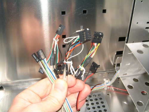

Dfran
Joined: 27 Feb 2005
Posts: 130
Location: Vermont
PostPosted: Tue, 03 May 2005 00:48:22    Post Subject: Reply with quote View Single Post
Look at the middle cable, and the one just on either side. There is a plug (which fits my mobo), and then there are the extra single plugs doubling back off from it. [Lian Li PC-6077, Asus A8N-SLI].

Joined: 01 Aug 2003
Posts: 2165
PostPosted: Tue, 03 May 2005 00:57:18    Post Subject: Reply with quote View Single Post
I ran into this with the last case I reviewed.
It is indeed the same thing. You can EITHER use the single 9 pin, or the singles, they do the same thing.
That was one of the cons in the review.
I think there is a pic in it...
Check bottom of page two here

PostPosted: Tue, 03 May 2005 07:14:06    Post Subject: Reply with quote View Single Post
damn, that IS a lot of wires!!
