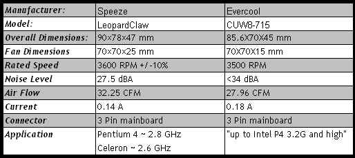

Compiled from the respective websites, the following table lists the key specifications of the two coolers.  As you can see, air flow, fan speed, size, and noise are all fairly close to each other. On paper, this looks like a fair fight... but that’s the point of testing, confirming the claims of the manufacturer.
