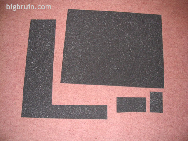

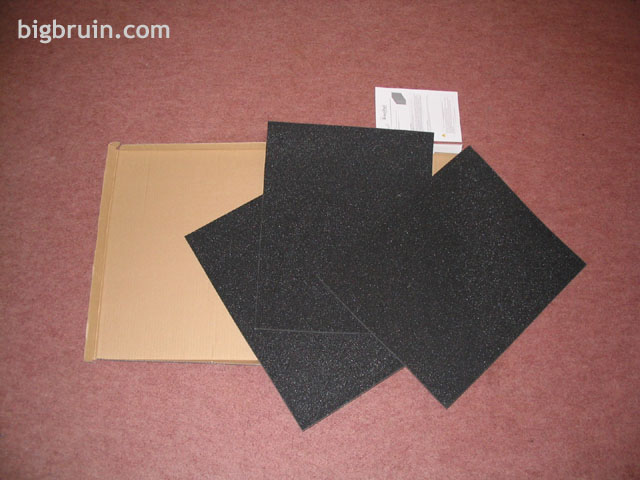

The AcoustiPack kit comes in the box pictured in the below left image, which is delivered from Quiet PC in another well packaged box. Considering the nature of the product, the great care taken to protect it may seem excessive, but better safe than sorry. The standard AcoustiPack kit consists of three 495mm x 395mm sheets (pictured in the below right image), which provides a total of 5,865 square centimeters of coverage. First impressions tell me that this seems to be more than enough to do a thorough job on any standard mini, mid, or perhaps full sized case.

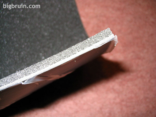

Each sheet of soundproofing is 7mm thick and consists of two distinct layers, as shown in the image below. The top layer is referred to as “Acoustic Foam” and is 5mm thick open cell foam. The lower layer “Acoustic Barrier” is 2mm thick and consists of a much higher density material. Below these layers is the adhesive backing which is quite tacky and should provide a strong hold on any surface chosen. 7mm thick may not sound like much, but this stuff is definitely heavy duty. The pack weighs in at 2.7 kg, which is roughly 6 pounds of soundproofing!

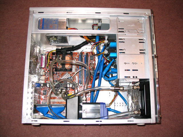

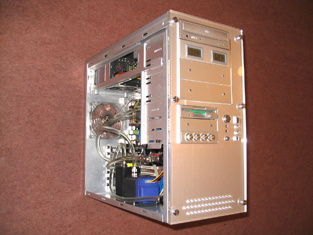

The system that this kit will be installed on is housed in an AMS gTower aluminum mid-tower case. Most of the components in the case were chosen to minimize noise, and the AcoustiPack will hopefully bring it a few notches closer to being silent. With an Innovatek water cooling kit for the Intel P4 2.6C and Radeon 9600XT, passive cooling on the Northbridge and other chips, two 120mm AcoustiFans connected to a fan controller, and a 500W power supply with variable speed fan, the system already runs very quietly.

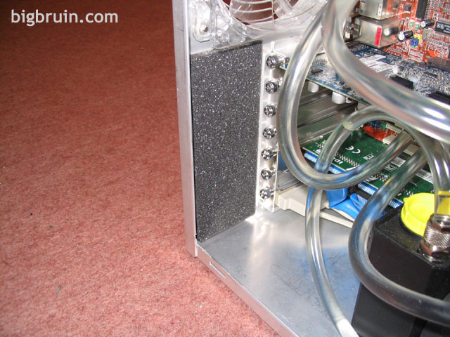

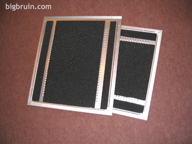

For my particular installation I decided to mount the AcoustiPack to the following locations: left side panel, right side panel, top panel, and rear panel next to the expansion slots. No soundproofing will be applied to the front of the case due to the lack of surface area found with the radiator, fan controller, and nearly full drive bays.
The images below show glimpses of the completed installation before closing the case back up.
Once I had covered the areas chosen, I still had plenty of AcoustiPack left for future use. The image below shows one full sheet and a few decent sized scraps which were left over that I intend to hold onto for future use.
