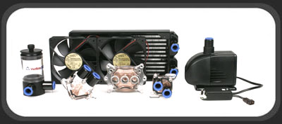

As we have seen in recent reviews at BigBruin.Com, water cooling comes in all shapes, sizes, and price ranges... From basic entry level solutions, to complete, ultimate performance kits. The Asetek WaterChill Power Kit would definitely fit into the latter category, as it is intended to provide some serious cooling to most modern CPUs, GPUs, and system chipsets. The complete name of the product up for review today is the WaterChill CPU/VGA/Chipset Power Kit - KT12A-L30 [115V/1/2'], and the main components are featured in the promotional image below...
