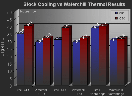

With all of the paramaters established for testing, lets get down to the results. First, we have the default speed results, comparing the stock coolers to the Asetek WaterChill components, at both idle and load conditions:
The chart above shows quite a bit of data, but the information is pretty clear. From left to right we have the CPU, GPU, and chipset results of the respective coolers labeled beneath each group. What is very clear is that significant improvements in cooling were achieved with the WaterChill kit! Of most interest to me is the drop of over 8 degrees on the CPU while at load, but across the board we see consistent improvements between 5-9 degrees Celsius. Definitely a nice boost.

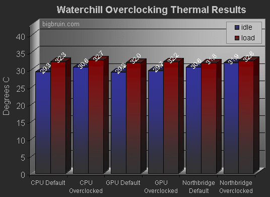

Now that the default speed temperatures have been brought down a little, lets see if there is any room for overclocking this system... The CPU has a default speed of 2.0 GHz, and the video card has a default speed of 325 MHz. With the WaterChill system in place, I finally had the confidence to up the speeds a little to see how high we could go. Unfortunately, that wasn't too high on the CPU... Although the issues were definitely not thermally related, blue screens appeared as I only made it up over 2.15 GHz, so my overclocking ceiling on the CPU was set at 2.13 GHz for the balance of testing (a 6.5% increase). The GPU responded a bit more kindly to overclocking, and a high of 375 MHz was established for testing (a 15.4% increase).
The chart above shows that the added heat created by overclocking the Athlon 64 really didn't do much to stress the WaterChill system. Temperatures rose by nominal values across the board, from mere fractions of a degree to a couple degrees maximum. Very nice! The overclocking may not have been extreme, but the performance of the WaterChill components tells me that it would be up for it!
