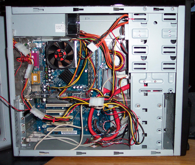

The image below is what my case looked like before removing my old power supply. With this setup I noticed that I could hear my power supply fan over my rear case fans.

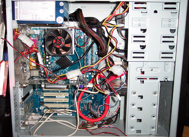

After removing my old power supply, which was the standard power supply that I received from Raidmax with my case, I installed the Enermax power supply. As you would expect, the screw holes lined up perfectly with the holes in the case, and left plenty of room for the exhaust fan. All the cables could reach where they needed to go, without any problems. But that’s ok, this was going in my small Raidmax (medium tower) case. If I was installing this in my large Antec (full tower), I’m not certain all the cables would reach. If they did, it wouldn’t leave much slack. Longer cables would be nice, but not a requirement. If this was a larger power supply (say a 400w+) I would expect the cables to be longer.
Here’s what my case looked like after I got the power supply installed and running. To me it looks much nicer since some of the cables are now wrapped. Would’ve been better if they were all wrapped.

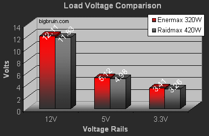

Using a Craftsman Auto-Ranging Multimeter (Model 82139), I recorded the idle and load voltage conditions of the Enermax 320W power supply, as well as my Raidmax 420W unit. The idle results were obtained with no applications running, while the load results were obtained with all of the following running; Agent, Dreamweaver, Photoshop, MS Access (1.5 Gig DB), City of Heroes, and BattleField 1942. The chart below shows the load voltages of each unit as measured on the 3.3V, 5V, and 12V rails.

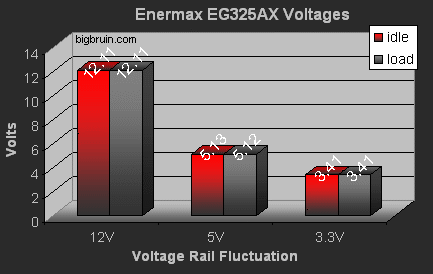

The following graph shows the results obtained on the Enermax recorded at both idle and load conditions.
As you can see the Enermax EG325AX-VE Noisetaker is very stable, especially when compared to the Raidmax test unit and its 100W edge in published power output. Even under a load it stays stable, with only a slight variation in the 5V rail. With zero fluctuation measured on the 12V rail, I would say Enermax's separate 12V rails for drives and the cpu/motherboard proved to be a worthy innovation.
