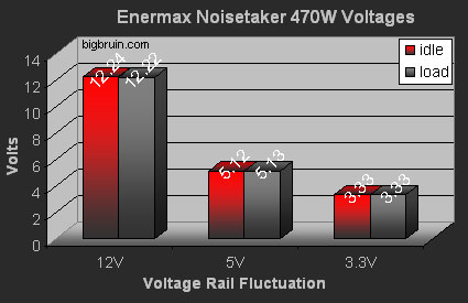

After the power supply was installed for a few days, we took the average voltages of the power supply at idle and load. Please note all benchmarks were made with the FSB overclocked to 240MHz. Load was simulated by running the distributed computing tool known as Folding@Home. Load voltages were only taken after stressing the computer for a minimum of one hour. Here are the average idle and load voltages taken directly from the 20-pin motherboard connector. As you can see, there was very little (if any) fluctuation on the rails. Voltages were taken multiple times to ensure these results were correct. The largest fluctuation existed in one of the 12V Rails, but it was only a difference of 0.02V.

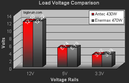

For comparison purposes, we put the Enermax Noisetaker up against a reputable Antec 430W power supply on the same test system. Both systems were well within their specifications, but the Antec had just slightly less fluctuation. When graphed, the results are very close, demonstrating the good job both companies have done to stay well within the industry standard of +/- 10%.
The Enermax Noisetaker was at most 3% from a "perfect" line voltage (12.00V, 5.00V, and 3.30V).
