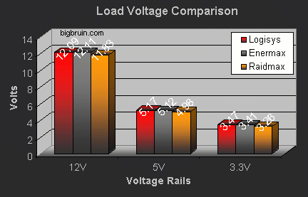

Using a Craftsman Auto-Ranging Multimeter (Model 82139), I recorded the idle and load voltages of three power supplies, the previously reviewed Enermax EG325AX (320W) and Raidmax 420W. The load values were recorded while running the following programs: Agent, Bulletproof FTP, Dreamweaver, Photoshop, MS Access with 1.5 gig DB, DVD Profiler, and World of Warcraft (Beta). Below you will see the load voltages for the three major rails, 12V, 5V and 3.3V...

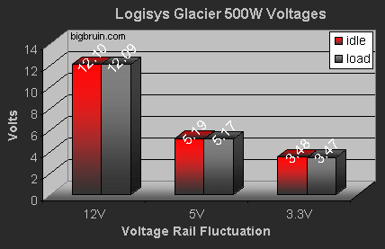

The following chart shows the performance of the Glacier 500W at both Idle and Load conditions...
The voltages of the Glacier were very stable, perhaps because I didn't have enough components to push it to the max. The rails were putting out a little more power than their “official” ratings.
