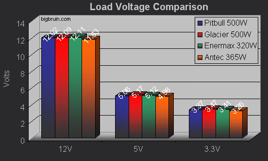

Using a Craftsman Auto-Ranging Multimeter (Model 82139), I recorded the idle and load voltages of three other power supplies, the previously reviewed Logisys Glacier 500w, Enermax EG325AX (320W) and Antec 365W. The load values were recorded while running the following programs: Agent, Bulletproof FTP, Dreamweaver, Photoshop, DVD Profiler, and Everquest 2. Below you will see the load voltages for the three major rails, 12V, 5V and 3.3V.

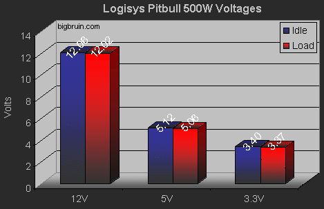

The following chart shows the performance of the Pitbull 500W at both idle and load conditions.
As you can see, the rails were putting out anywhere from 0.5% to 2.0% additional power over the rail specifications.
After the performance of the Logisys Glacier, I was curious whether this new power supply could improve upon the poor performance of the previous Logisys. I'm happy to report that this power supply performed flawlessly!
