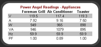

The next phase of testing was very similar to the first phase, except now with the appliances listed below:
• George Foreman Grill: Family sized, rated at 1000W, 60Hz, 120V
• Procter-Silex Toaster: 2 slice, rated at 900W, 60Hz, 120V
• Hampton Bay Air Conditioner: rated at 10,000 BTU, 10 AMPS, 1050W, 60Hz, 115V, 9.5EER
Per their specifications, these devices can draw some serious juice! In this phase of testing I am mostly interested in seeing how close to the published specs the real world performance comes.
The table above details the results, and shows that these devices do stick to their specifications, within a reasonable tolerance. Of interest is the higher current being drawn here... It makes it crystal clear to me that I can not plug these three devices into outlets on the same 20A breaker, and that perhaps I want separate my air conditioners (I have two of these 10,000 BTU behemoths) from being on the same 20A breaker!
