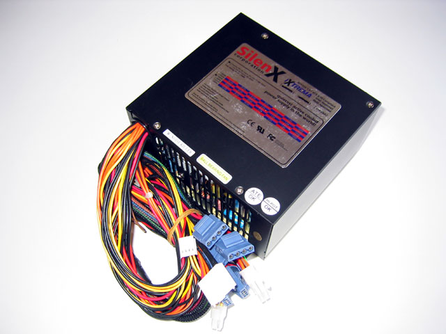

The front has all of the obvious cables for powering your system, noted in earlier in the review. Most cables provided in this unit were approximately 18" in length and although not particularly long, these cables easily reached in our large server case.
The most innovative feature of this power supply is the SilenX molex connectors. They are much easier to insert and remove than the typical connectors because the plastic loops give you something to grip. This is a great improvement over the typical molex that I find myself time and time again wiggling back and forth, other power supply manufacturers should take note.

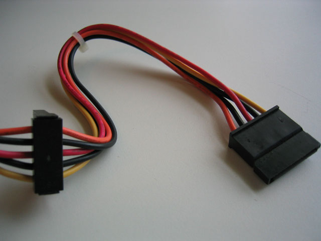

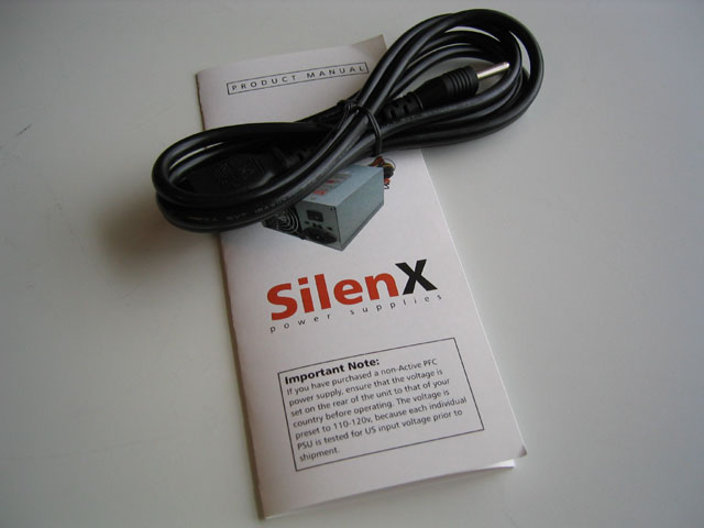

The below left image shows the manual and AC power cord included, while the below right image shows the two Serial ATA power connections integrated with the power supply.

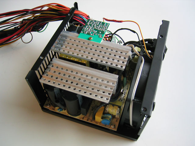

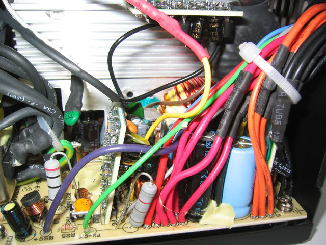

When the top of the device is removed it reveals a tightly packed assortment of circuit boards, wires, and resistors – just as you could expect with any other power supply today. On closer inspection you might notice this device comes with a small thermal diode designed to read the ambient case temperatures and adjust the cooling fan accordingly. A nice touch for the computer user with a nearly silent computer in mind.

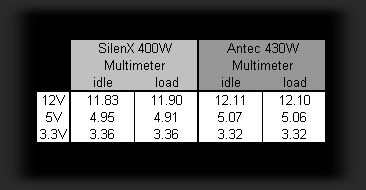

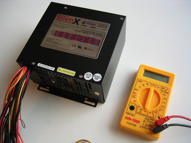

The SilenX 400W power supply was benchmarked in two stages, testing the voltages at idle and load. The power supply was connected to the test computer and voltages were taken directly from the 20-pin motherboard connector. A Cen-Tech (model P30756) multimeter was used to test the power supply with the black lead touching a black wire on the motherboard connector and the red lead moved to the respective voltage line. (yellow being the 12.0v line, red the 5.0v line, and orange the 3.3v). It is worth noting, every molex connector (all six of them) was utilized to hook up the assortment of power hungry components in this system. A few more molex connectors will be necessary for someone with more than 3 hard disks and 2 optical drives.

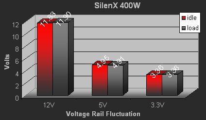

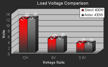

To get an accurate indication of the SilenX 400W power supply's performance, we took the average voltages of the power supply at idle and load. Load was generated by a running a combination SiSoft Sandra Pro 2004 (Burn-in Wizard) and F@H. Load voltages were only taken after stressing the computer for a minimum of one hour. Here are the average idle and load voltages taken directly from the 20-pin motherboard connector. Note, there is little fluctuation between idle and load and all voltages are well within specifications.
For comparison purposes, we put the SilenX power supply up against a reputable Antec 430W power supply with the same test system. Both systems were well within their specifications, but the Antec definitely had less fluctuation. Both though, when graphed are very close and demonstrates the good job both companies have done in staying well within the industry standard of +/- 10%.
