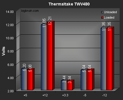

I tested this supply a little different than the normal way. I used a Seasonic Power Angel to measure key power measurements. The Seasonic device also includes a dummy load box for loading down a power supply.

With the Power Angel measuring power supply input voltage, I grounded the sense lead and took some measurements. Completely unloaded the TWV480 showed a total load of .26 Amps, 20 Watts, 31VA that works out to a power factor of .66 (P/VA=PF or 20/31=.66) or 66% efficient. Loading down the supply to 193 watts, 2.16 Amps, and 257VA, the power factor came out to be .73 or 73% efficient. These are the conditions that I measured the output voltages listed in the chart below.

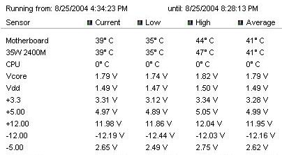

With my entire machine churning away hard, Motherboard monitor showed excellent voltages coming out of this supply. The –5 Volt rail discrepancy has always existed on this motherboard with MBM. The –5 Volt rail was not –2.6 volts as indicated when measured with a DVM. There were a few fluctuations when a 4-hour snapshot was taken from the low/high screen, but nothing to be overly concerned about.
