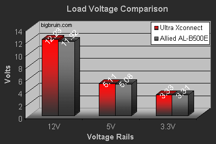

The first phase of testing involved recording voltages from the +5V, +12V, and 3.3V lines while the systems were under a substantial load. The load condition was established with Folding@Home and SiSoft Sandra 2004 Professional's Burn-In Wizard running, in addition to the Hardware Doctor, for a period of about 30 minutes. The chart below details the results.
As you can see by the data presented, both power supply units provide results well within the generally accepted +/-10% tolerance, and easily handle the load placed on them. The Ultra Products Xconnect unit does provide slightly stronger readings on the 3.3V and 5V rails, while the advantage on the 12V rail is far more substantial. What the chart can not convey is the stability of the readings that are reported. The Ultra Products readings were nearly static during testing, with fluctuations of only a few hundredths of a volt on the 12V and 5V line. Meanwhile, the Allied power supply's 12V rail was very active while under load, swinging from a low of 11.86V to a high of 12.41. The stability of the Xconnect's rails was very impressive.

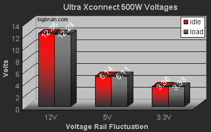

As a point of reference, the Ultra Products Xconnect's load voltage readings are charted against the idle voltage readings below. The idle readings were obtained with only the Hardware Doctor application running for 15 minutes after a reboot.
The difference between idle and load are minimal, and all readings were very stable, with minimal to no fluctuations on any rail.

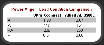

As a final phase of testing, the two power supplies were connected to the Seasonic Power Angel power monitor, and data was recorded with the systems in the loaded condition, as described previously. The chart below details the information provided by the Power Angel, and provides some interesting information...
While powering the same system, the Ultra power supply is able to draw slightly less current from the wall outlet, and in turn provides lower values for both W (wattage) and VA (voltsxamps). The PF number is perhaps of most interest, as it indicates that although neither unit is overly impressive with their respective power factors, the Ultra unit is 6% less efficient. If Ultra is looking for any possible way to improve this power supply, perhaps an active power factor correction model would be a good direction to take!
