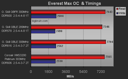

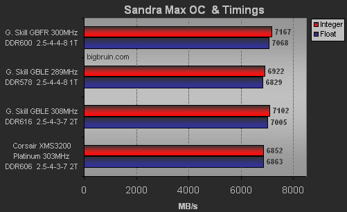

My first thought would have been that the two sets of G. Skill would have been nearly identical having the same Samsung 440 chips. How wrong I was. When trying to overclock the GBFR set, I could not raise the speed even 1MHz above three hundred without failing the stability testing. I tried a range of voltages including 2.7, 2.8 and 2.9Volts. I then tried to tighten timings at 300MHz and again could not get the timings any tighter than the stock 2.5-4-4-8. The last thing I tried was to set the CPC to 1T and to my surprise it ran flawlessly again only at 300MHz with the same timings, this setting worked only at 2.7 volts.
The set of GBLE was good up to 308MHz with timings of 2.5-4-3-7 2T at 2.8V. In order to achieve a setting of 1T with this set I had to drop the speed down to 289MHz, although at this speed I was also able to tighten the timings to 2.5-4-3-7 1T.
Finally, I took a shot at the Corsair sticks, getting a high of about 303MHz with timings of 2.5-4-3-7 2T. I then tried to find where I could get a 1T setting, giving up somewhere around 260MHz when I still couldn’t find a stable point. The graphs show the bandwidth and read/write at the above mentioned settings.
