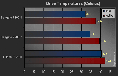

Thermal testing was carried out over the course of all the other benchmarks executed. An external thermal probe with LCD display was used to monitor the skin temperature of each drive. The probe was placed on the side of the drive, roughly at the center of the surface. The chart below details the maximum sustained temperatures achieved while the drives were powered on but inactive (Idle), and while the drives were under stress due to the testing (Active). Ambient conditions were maintained at 22C throughout the testing, and no cooling fans were directed onto the drives.
The Hitachi Deskstar 7K500 starts out much warmer than the two Seagate drives, and under activity it gets even warmer. The rise from Idle to Active conditions is less on the 7K500, but with such an elevated base temperature, that is of little comfort. The temperatures are not excessive, and could easily be dropped with even a mdoest cooling fan, but cooler electronics are generally happier electronics (longer life, more stable performance).
The Hitachi software allows for temperature monitoring, and once the testing was completed, I got into their application as quickly as possible. Perhaps one minute after the external probe reported 42.5 degrees Celsius, the software reported a temperature of 43 degrees Celsius. Their readings are from within the drive, and given the brief time it was allowed to cool off, this number seems to confirm the skin temperature readings.
