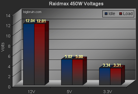

Power Supply Performance:
Using a Craftsman Auto-Ranging Multimeter (Model 82139), I recorded the idle and load voltages while running the following programs: Sisoft Sandra Burn-In Wizard, Folding@Home, and Everquest 2 for several hours. Below you will see the load voltages for the three major rails, 12V, 5V and 3.3V.

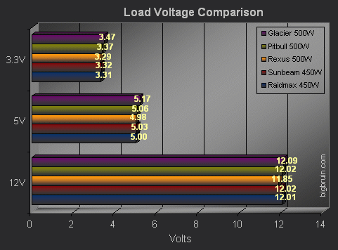

The following chart shows the performance of the Raidmax 450W at load conditions, compared to several other power supplies.
As you can see, the rails were putting out anywhere from 0.2% to 0.4% additional power over the rail specifications during Idle. During load conditions the voltages are pretty stable, barely fluctuating from the Idle ratings. Even with 34A rating of the 5V rail, the voltage readings were stable under a good load.
