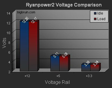

The first thing I wanted to try was running everything as hard as possible. I started out by transferring 6 gigabytes of files across the network to the 4 RAIDed drives, copying a DVD to the Raptor hard drive, and simultaneously running 3Dmark 2001 to load the processor and graphics card down. The whole time this was going on, all controllers had all the lights and fans running full blast. To add to all this, I plugged my Corsair Voyager flash drive and a USB 2.0 portable laptop drive into the front USB ports and had a file transfer going between the two of them. I was expecting things to get a little unstable at the best and to crash miserably at the worst. Needless to say, everything was running quite slow, but as the High/Low event monitor in Mother Board Monitor shows below, the +3.3V and the +5V rails did not dip or rise a bit! As a side note, for the life of me I cannot get Mother Board Monitor to report either of the 12V rails. I monitored the +12V rail with the min/max functions on a Fluke multimeter and found no significant fluctuations there either.
To make sure Motherboard Monitor was reporting voltages correctly, I used the same Fluke multimeter to check voltages. The results are shown below. Again, extremely small fluctuations between unloaded and loaded conditions. Not only that, but the voltages are very close to where they are supposed to be.

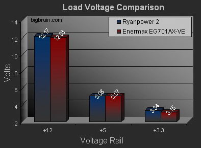

The graph below shows how the AC Ryan Ryanpower2 compares to the Enermax EG701AX-VE when powering the “kitchen sink”.
