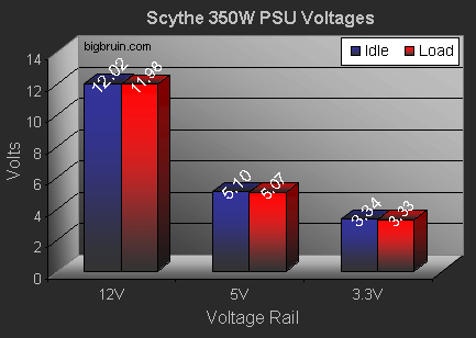

The chart below lists the idle and load voltages I received:
As you can see the power is pretty stable, operating near the optimum voltages. The 12V rail dipped slightly below the 12V's it's supposed to carry.
With all the components listed above installed for the readings, I was well over what the power supply should be able to handle. Using an online Power Supply estimator I had enough components installed to need at least a 360W power supply. I connected the Antec 365W power supply I have, and the video card reported it was not receiving enough power to operate correctly. I never received this message when using the Seasonic/Arctic 450.

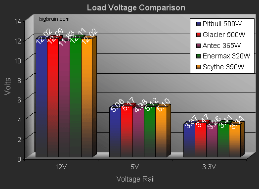

Here you are able to see the how the various rails hold up when compared to various power supplies.
