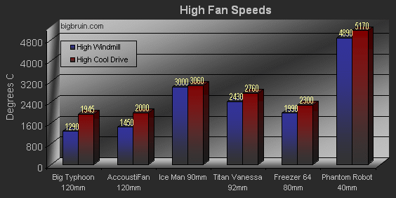

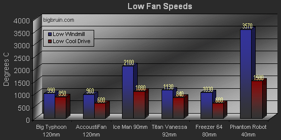

From the previous pictures you can see that 6 fans were installed on the Sunbeamtech Chromatic Windmill for testing. The following fans were installed and evaluated for minimum and maximum speed, and compared to the information reported by a Cooler Master Cool Drive IV control panel.

The graph below shows the comparison of the minimum speeds achieved with the Chromatic Windmill and the Cool Drive IV. As you can see, the fan speeds varied a great deal. Anywhere from 15% to 60% speed differences! I verified each of these speeds several times to confirm the readings.
The graph below shows the comparison of the maximum speeds achieved with the Chromatic Windmill and the Cool Drive IV. Sometimes the speeds were pretty close (within 2%), other times there was a large difference in reported speeds (up to 50%). The Chromatic Windmill doesn't seem to have as much of a fan speed range as the Cooler Master Cool Drive IV.

Since I evaluate many items including fans, I need to be able to find out the lowest and highest speed they can achieve. Unfortunately the Sunbeamtech Chromatic Windmill doesn't have as wide of a speed range as the Cool Drive IV. For the average person that wants to control fans, this shouldn't be an issue. As I said, I test many fans and need to get the true lowest speed possible (i.e. just before they stop working from lack of power).
