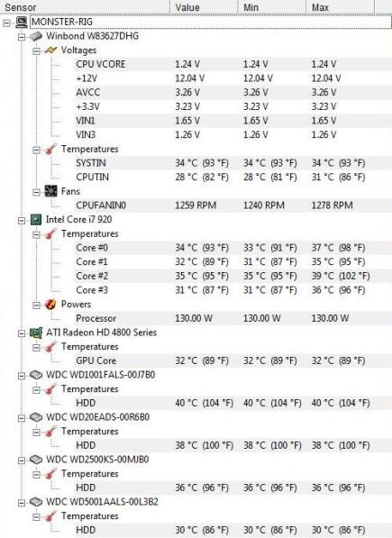

This is with my CPU and GPU OC'd. I wonder why the +12V numbers arent showing 12V? Even Speedfan and Everest report the same numbers. But in the BIOS, it will show 12V values (e.g., 12.3v). Something wrong with my PSU... Confused

PostPosted: Tue, 14 Apr 2009 10:54:27    Post Subject: Reply with quote View Single Post
Nothin wrong with your PSU.........Wink
Every software program reports temps and voltages differently because they aren't a difect reading. What is happening is that the hardware health reporting chip on your mother board is using a poorly programmed algorithm to calculate the values and that in turn is read by the reporting software. Some software is programmed better than others with more support for different health monitoring chips and hardware chipsets.
To get the correct voltage values if you're worried about the health of your PSU is to use a quality multimeter and take the reading directly from the output power cables.

Posts: 20350
PostPosted: Tue, 14 Apr 2009 10:59:23    Post Subject: Reply with quote View Single Post
Exactly - nothing to worry about.
I leave HWMonitor running all the time, and see that over the last few days my PSU's 12V rail has apparently varied from 0V to 14.22V. Grin
