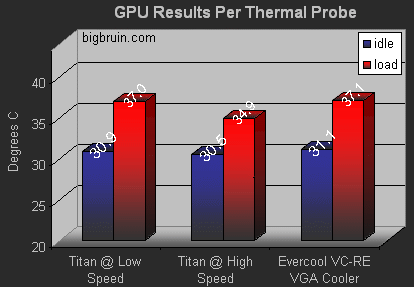

The GPU was put through a similar set of tests, and the Titan TWC-A04 GPU block was now put head-to-head with the Evercool VC-RE Twinkling VGA cooler. The video card in question does not have an onboard thermal sensor, so the digital thermometer provided by HighSpeedPC.com was utilized. By sticking the sensor to the side of the GPU, overlapping onto the waterblock, reasonably accurate temperatures should be acquired, and the differential in temperatures will confirm any performance gains over the VC-RE.
The idle portion of the testing occurred simultaneously with the CPU idle testing, and results were recorded. For the full load testing, 3DMark03 was run continuously, with results monitored on the thermometer for one hour. The graph below compares the idle and load results of the GPU with the two coolers installed.
The Titan TWC-A04 GPU performance was able to hang with the VC-RE, which had previously won my praise for its excellent temperatures. The Titan manages to do so with zero added noise, as the VC-RE fan does create a bit of a buzz, and after several months of use has develop a bit of unbalance at startup. What no doubt helps the GPU water block is the fact that the secondary radiator is just upstream from it, removing the heat from the CPU, and providing an extra boost of cooling to keep the video card temperatures low.
