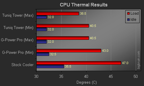

Each cooler was allowed to run for 60 minutes in both the idle and load conditions, and an external thermal probe was used to monitor the maximum sustained temperatures. The Tuniq Tower's fan speed controller was used to test the cooling power at both its maximum speed (indicated as 2163 RPM) and its minimum speed (indicated as 1241 RPM), and the Gigabyte cooler's maximum / minimum speeds were 3125 / 1795 RPM. The thermal probe was also used to confirm that the ambient temperature during testing was held between 23 and 24 degrees C. The chart below summarizes the results...
The Idle portion was conducted first, and when I saw that the Tuniq Tower could do no better than the Gigabyte cooler, I was a bit disappointed and assumed the Load portion of the test would be the same story. I was quite surprised, and relieved, to see how much better the Load results were on this cooler. The Tuniq Tower at minimum speed did just as well as the Gigabyte cooler when set to maximum speed. Turn the speed up on the Tuniq Tower, and the performance just gets better!
In addition to the cooling performance, the noise level was quite impressive. At minimum speed, the sound of the 120mm fan disappears among the other noises from within the test system's case. At a mere 1241 RPM it is easy to understand why. Even at full speed, despite being noticeable, the noise from the fan is not nearly as loud as the Gigabyte cooler's, and it has a much lower pitch than most fans making it far less annoying. I have found my "sweet spot" at about 1500 RPM, where the sound is almost non-existent and the cooling performance is within a degree or two of the maximum speed results.
